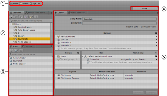

The Users Layout
The Users layout consists of seven panes: Active Sessions, Details, Help, Layouts, MediaCentral Zones, Roles, and User Tree. The following illustration shows the default layout with several panes displayed. In this illustration, the group Journalists is selected and the Details pane shows information about the group.
| Display or Control | Description |
1 | Menu bar | Includes the same items as the Menu bar in other MediaCentral UX layouts. The contents of the Panes menu is specific to the Users layout. |
2 | User Tree pane | Displays the contents of the user database. For more information, see User Tree Pane. |
| Media Central Zones pane | Lists the registered MediaCentral zones. Configuring MediaCentral servers as MediaCentral zones allows the servers to share a central User Management Service (UMS). It also allows users to search for assets across multiple zones and to have remote assets delivered to the local zone. For more information, see Working with MediaCentral Zones. |
3 | Roles pane | Lists the default roles and any roles you created. For more information, see Creating, Deleting, and Assigning Roles. |
| Layouts pane | Lists the default layouts and lets you assign access to users or groups. For more information, see Creating and Deleting Roles and Assigning Layouts to a Role. |
4 | Layout selector | Includes the same options as other MediaCentral UX layouts, but only administrators have access to the Systems Settings and Users layouts. For more information, see Available Layouts: Administrators and Users. |
5 | Details pane | The Details pane displays information about the group or user you double-click in the user tree. If you double-click the top-level group (Users), the pane lets you specify information about the selected Authentication Provider. The Details pane also displays information about a selected role or zone. |
| Active Sessions pane | The Active Sessions pane displays a list of users who are currently signed in to the MediaCentral UX Web application. For more information, see Viewing and Ending Active Sessions. |
