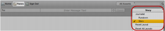

You select a layout from the Layout selector, located near the upper right corner of the window. The menu shows the name of the layout that is currently displayed. If you click the menu, it shows the name of the role or roles for the signed-in user, along with the layouts that are available for that role. You can select any layout that is displayed.
The following illustration shows the default layouts available to the Journalist role.

To change to a different predefined layout:
*Choose the layout from the Layout selector.
*Changes that you make to a predefined layout are saved when you change to a different layout or when you sign out.
To close a pane:
*Click the X on the pane’s tab.
To open additional panes:
1. Select the Panes menu.
2. Select the menu option corresponding to the pane you want to open.
The pane you select opens in the active area. For more information, see Working with Areas and Panes.
To reset a layout to its original configuration:
*Select Reset Layout from the Layout selector.
To reset all layouts to their original default configurations:
*Select Reset All Layouts from the Layout selector.
