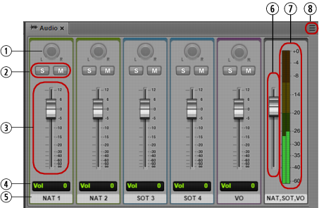

The following illustration identifies controls in the Audio pane when an advanced sequence is open in Output mode, Mix Mode is set for Stereo, and the position indicator spans all three tracks.
Control
Description
1
Panning knob
Controls the panning for each track. In the current release, the panning buttons are inactive. See Panning for Advanced Sequences.
2
Solo and Mute buttons
Click the S (Solo) button to monitor only the selected track or tracks. All other tracks are muted. Click the M (mute) button to mute only the selected track or tracks. Gray M buttons indicate audio is enabled. See Soloing and Muting Tracks for Advanced Sequences.
3
Volume slider
Click and drag the slider to adjust the volume level for an audio clip. The level applies only to the selected segment of a track, not to the entire track. These adjustments are saved with the sequence. See Adjusting Audio Levels for Advanced Sequences.
4
Volume level display
Displays the level selected by the volume slider.
5
Track identifier
Identifies the track associated with the audio controls. By default, mono tracks are labeled NAT, SOT, and VO. For stereo tracks, labels by default are NAT 1, NAT 2, SOT 1, and SOT 2. The identifier for the master slider shows which tracks are currently monitored.
A MediaCentral UX administrator can change the labels that identify each track by changing the settings in the Interplay Administrator Application Database Settings. For more information, see Configuring Settings in the Interplay | Production Administrator.
6
Master volume slider
Click and drag the slider to adjust the volume level for overall audio mix in the sequence. Changes are not saved. See Audio Monitoring for Assets and Basic Sequences.
7
Audio meters
Displays the audio level for the solo tracks of the sequence, or the overall mix of the sequence. There are two meters. For stereo output, each meter displays a separate level. For mono output, both meters display the same level. See Setting the Audio Mix.
8
Pane Menu button
Provides the following options:
• Mix Mode: Select Stereo or Mono to specify the audio output. See Setting the Audio Mix.
• Set Reference Level: Lets you set the reference level for audio monitoring. See Setting the Reference Level. The default is -20.
• Help: Displays information about the audio pane. Use the Help control buttons to access other Help topics.
