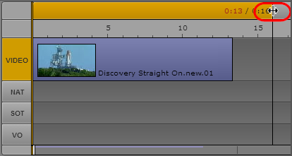

1. Move the mouse pointer to the outside border of a timing block header so that a two-headed arrow appears.
2. Click the border of the header.
The timing block header turns orange.
The timing block does not need to include media. Media does not need to be selected.
3. Drag the border to shorten or lengthen the duration of the timing block.

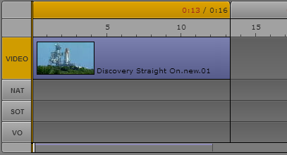

The following illustration shows a timing block duration shortened to match the duration of the video. Note that the media duration (0:13) does not match the text timing (0:16).
