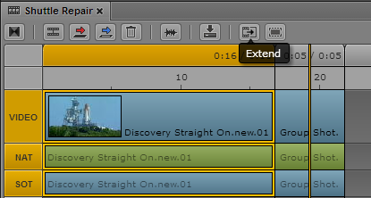

The following illustration shows a selected segment (Video plus NAT plus SOT) in the first timing block. The position indicator is in the middle of the second timing block, which is the location into which you want to extend the segment. The tool tip for the Extend/Retract button displays “Extend.”

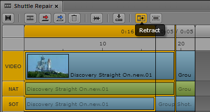

After you click the Extend/Retract button, the video and NAT for the selected segment extend into the second timing block. The selected video and NAT overwrite the video and NAT in the second timing block, without affecting the SOT. The Extend/Retract button turns orange and its tool tip changes to “Retract.” This indicates that the selected segment is extended and you can click the button to retract it to its original position, as shown in the following illustration.
You can return the extended segments to their original duration by clicking the Extract/Retract button to retract the segment.
