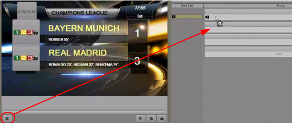

1. Click the drag-and-drop button in the bottom left of the Maestro Browser window, drag the icon to the Queue/Story pane, and drop it on a segment of an iNEWS story.

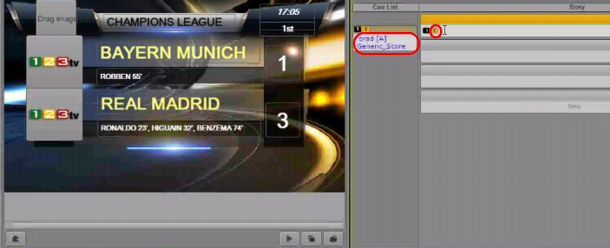

A production cue is created in the cue list. An asterisk indicates that the cue is a machine control instruction. In the following illustration, “Orad” refers to the MOS object name and “Generic_Score” refers to the name of the graphic template.
2. Save the story.
