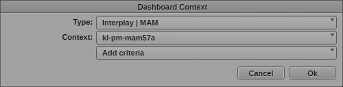

1. Click the Pane Menu button of the Process Dashboard pane and select Define Context.
The Dashboard Context dialog box opens.
2. Select the source type from the Type list. The list shows all available process sources.
3. Select the system from the Context list. The list shows all Interplay MAM systems that you can use (depending on your license) and that support the process dashboard features (systems based on Interplay MAM v5.7 or later). Therefore, the list may not be identical with the list of Interplay MAM systems shown in the Launch pane. If no system is available for the selected type, a corresponding message is shown instead of the Context list.

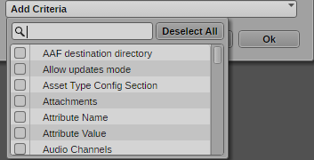

4. (Optional) Click the Add Criteria selector.
The criteria selector window opens. It shows all filter criteria that you can use for defining the dashboard context. Currently you can use text, date-time, and legal list properties and contributors. All entries are deselected by default. You can use the search box to find a particular criterion.
Select the criteria to be added and click anywhere outside the window to add the criteria to the Dashboard Context dialog box.To remove a criterion from the context definition, click the Minus button at the right of the field.

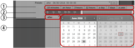

6. (Optional) If you added a criterion of type date-time, click the date field.
The date picker window opens.
1 | Shortcut buttons | 3 | Scope menu |
2 | Date slider | 4 | Date picker |
a. If you want to define a date range, click the Scope menu and select one of the following. Note the you cannot use “between” and “before.”
- after — The time value is later than the given value.
- any — All criteria can be set to a neutral mode called “any” where the criteria do not affect the results. Use this if you want the criterion to be used for the context of the Process Dashboard, but you do not want it to affect the results.
b. To specify a date range, do the following:
Click one of the shortcut date buttons to set your criterion for one of the common time spans. The shortcut date buttons indicate the time from the present.
Use the date slider to specify a time span for your criterion. The date slider indicates the time from the present.
Use the calendar to select the appropriate dates for your criterion.
The date slider adjusts to match the date options you select, and the date-time field displays a text summary of your date criteria.
c. If you want to modify the time values to specify an exact time in hours, minutes, and seconds, click a time value displayed in the criterion text box, and type a new value.
When you type a legal value, the next value is automatically selected. You can also navigate between the values for hours, minutes, and seconds by using the arrow keys, or by pressing the Tab key or Shift+Tab to move to the following or preceding value.
