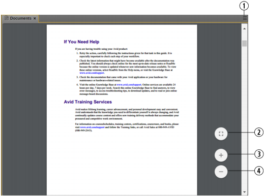

The following illustration shows the Document pane and identifies its controls.
Display or Control
Description
1
Pane Menu button
The Pane menu for the Documents pane contains the following options:
• Actions. Creates a process in the MAM system and attaches the asset to the process. See Creating Processes.
• Download. Downloads the document. If you do not have the privileges for downloading or the asset does not contain a “HiRes” file, the Download link is disabled.
• Help. Displays a Help topic describing controls in the Documents pane. From this topic you can access the entire MediaCentral UX Help system.
2
Fit to Page / Fit to Width toggle button
Toggles the display of the PDF document page in the pane:
• Fit to Page: Displays the entire PDF page in the pane.
• Fit to Width: Adapts the PDF page to the width of the pane.
3
Zoom In button
Increases the magnification of the PDF page in the pane.
4
Zoom Out button
Reduces the magnification of the PDF page in the pane.
