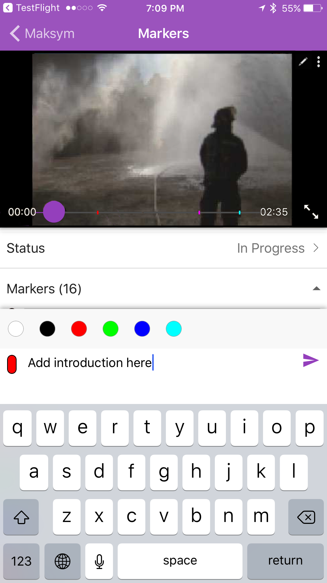

To edit an existing marker:
1. Tap the Edit Marker button for the marker you want to edit.
The Marker menu opens.
2. Tap Edit.
The Marker view opens in edit mode.
3. Use the keyboard to edit the marker text.
4. Tap the Done button.
Text is saved and you exit edit mode.
*You can cancel your edit by tapping outside the Notes field.

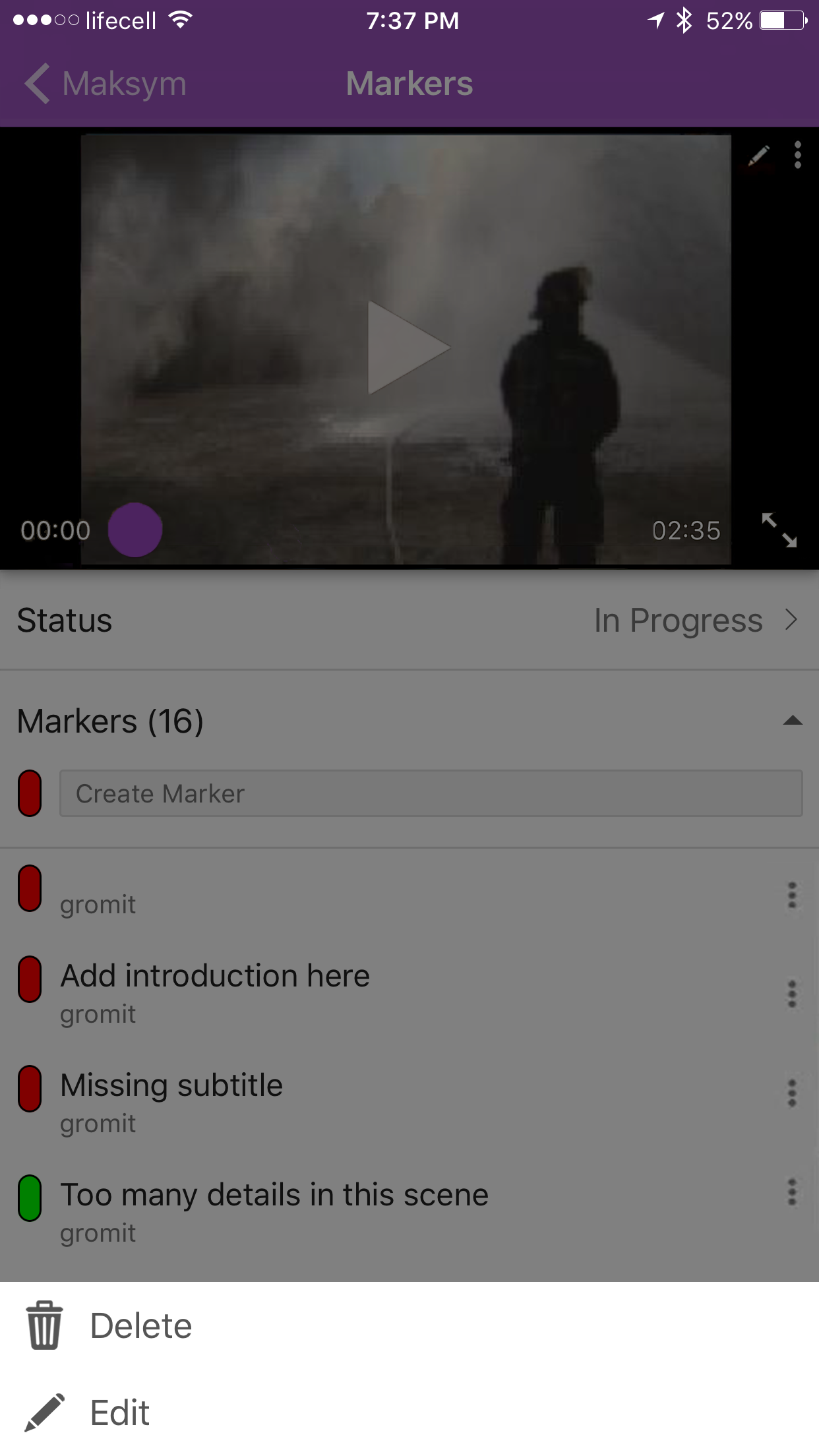

To delete an existing marker:
1. Tap the Edit Marker button for the marker you want to delete.
2. Tap Delete.
The marker is deleted from the clip or sequence, and the marker is removed from the timeline.
