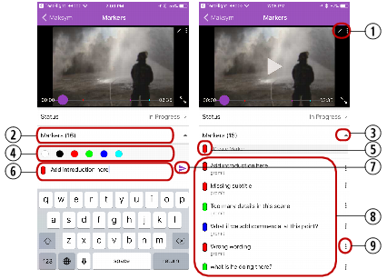

A marker is an indicator that you add to a selected frame to mark a particular location in a clip, subclip, or sequence. Markers can have icons of different colors and can be associated with user-defined comments. Markers display in the timeline and in the Markers list below the Media player.
*To create and modify markers, a MediaCentral UX user’s Interplay Production account must be configured with the necessary permissions. For information on configuring marker permissions, see Understanding Markers and Restrictions.
You can add and edit markers in the MediaCentral UX mobile app for iOS devices in the Markers view if you have the necessary user permissions configured in Interplay Production. An Interplay Production administrator sets these permissions in the Instinct/Assist User Settings view of the Interplay Administrator. For more information, see the Interplay | Engine and Interplay | Archive Engine Administration Guide or the Interplay Production Help.

1
Create/Edit Marker button
Allows you to create a new marker. This button displays if you have the necessary user permissions to edit the video asset.
2
Status bar
Displays the status of the marker. This bar is only visible if your Interplay Production configuration supports approval of markers — see Setting the Approval Status for Assets.
3
Show/Hide Marker list button
Expands or collapses the Marker list.
4
Change Marker Color bar
Allows you to change the color of any marker.
5
Create Marker button
6
Notes field
In edit mode, allows you to add or to modify text.
7
Done button
Commits your changes and exits edit mode.
8
Marker list
A list of the markers in the clip or sequence. Markers are sorted by timecode. You can scroll the list to see all markers.
9
Edit Marker button
Allows you to edit or delete an existing marker.
