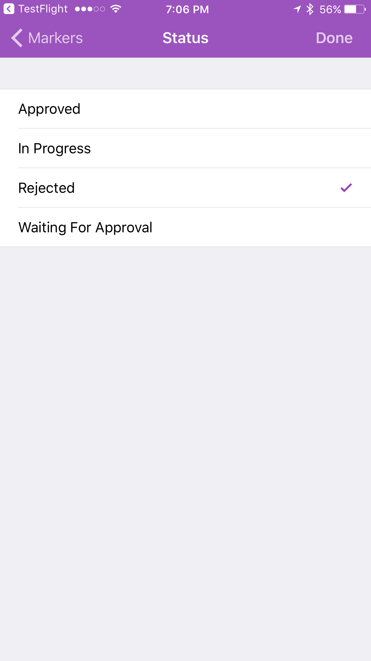

When enabled through the Interplay Administrator tool, a Status bar appears between the Media viewer and the Markers list. Tapping the Status bar displays the “Select approval status” window:
Assets are not associated with a default status.
The approval status window displays a list of options that can be customized as desired. When the user taps an item in the list, a check mark appears to the right of the selection. Tapping Done saves the selection.
