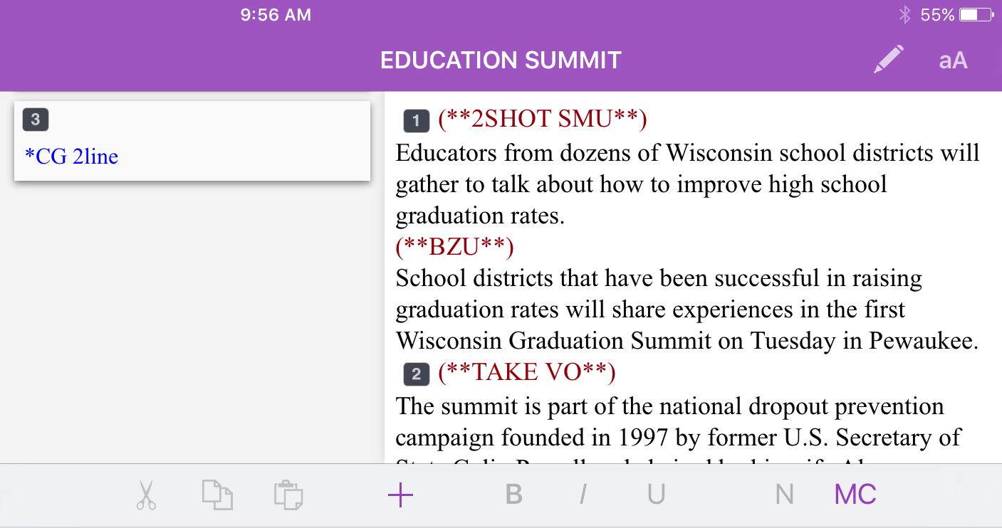

*With your cursor in the production cue area, tap the MC (machine control).
*Type an asterisk (*), which automatically switches the text you type from Normal to Machine Control format.
Machine Control format appears as blue font
3. Type your machine control command — for example, *CG 2line — and then press Return.
4. Type the first line of text that should appear on the 2-line CG graphic — for example, John Smith — and then press Return.
5. Type the second line of text for the 2-line CG graphic — for example, Pleasantville, USA.
Your CG machine control instruction appears in blue font.
