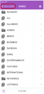

To open a directory:
1. Navigate to the directory.
2. Tap a folder on screen to open it.
*As you navigate the system’s directory structure, the app displays your path or location within the database at the top of the screen.
The following illustration shows the Wires directory opened to view numerous queues containing incoming wire stories.
Wires directory on the BSI-C3PO iNEWS server, with the back button at the top of the list

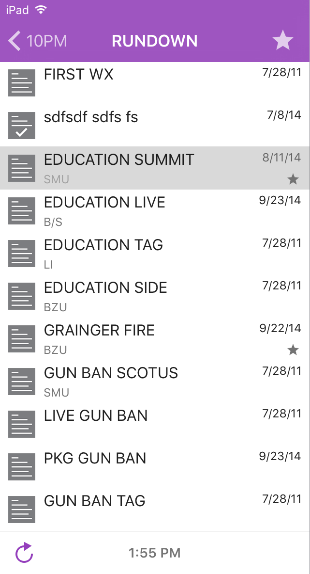

To open a queue:
1. Navigate to the queue inside a directory.
2. Tap the queue to open it.
The following illustration shows an example of a rundown queue.

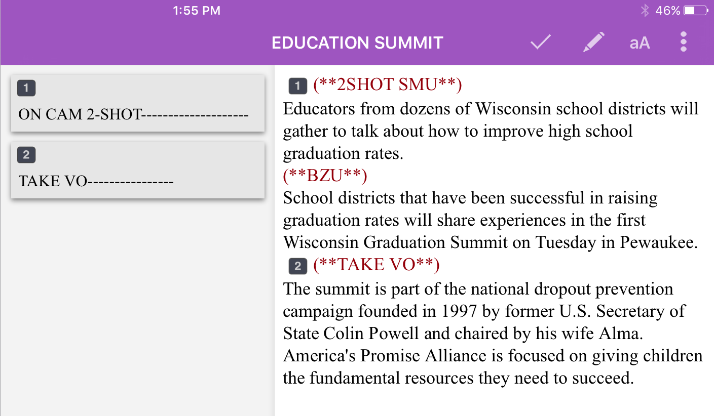

The story opens in the Script Editor, which has two sections:
- The Cue List, located on the left side, which contains any production cues or machine control instructions.
- The Story, located on the right side, which contains the text of the story, any presenter instructions, and production cue markers.
In portrait view, the sidebar is hidden by default. You can swipe right to display or swipe left to hide the sidebar in portrait view.
The following illustration shows the Script Editor with a story containing production cue markers identified numerically. These markers align with production cues and machine control instructions displayed in the Cue List to the left of the story. Blue text indicates machine control instructions. Black text indicates production cues. Red text in the body of the story indicates presenter instructions.

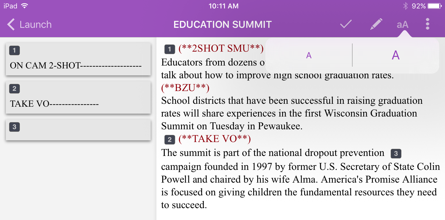

To adjust the size of the text of your story:
1. Tap the Change Text Size button.
The Change Text Size controls open.
2. Do one of the following:
*Tap the smaller letter icon to reduce the text size.
*Tap the larger letter icon to increase the text size
You can tap the letter icons multiple times to reduce or increase text to the appropriate size.
3. Tap anywhere on the screen to dismiss the Change Text Size controls.
