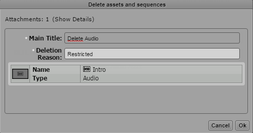

The Delete Assets and Sequences process dialog box opens and shows the assets that are to be deleted as attachments.
5. Provide a main title and a reason for deletion.
6. Click OK.
The Delete Assets and Sequences process dialog box is closed and the delete process is triggered.
