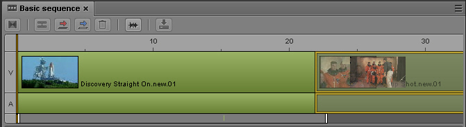

The timeline for a basic sequence has two tracks: video (V) and audio (A). A basic sequence uses green for video and audio, as shown in the following illustration.

2. Drag the asset from the Media viewer to the timeline until your pointer is over the V or A track, as shown in the following illustration.
As you drag the segment to where you want it, the V and A tracks appear highlighted in orange to show you where the asset will be inserted when you release the mouse button.
3. Release the mouse button.
The asset is inserted into the timeline and the position indicator moves to the first frame of the next segment.
