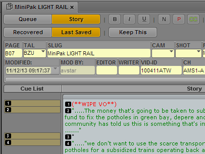

Click the name of the asset to open the last saved version. If the asset is a story, the Queue/Story pane displays three additional buttons:
- Recovered: Click this button to open the recovery file (from the local system).
- Last Saved: Click this button to open the last saved file (from the Interplay Production database).
- Keep This: Click this button to save the version that you display and delete the other version.
If the story includes a script sequence, and the Sequence pane is open, these buttons are displayed on the Sequence pane.
You can switch back and forth between versions to compare them, and click the Keep This button when you decide which version to keep.
