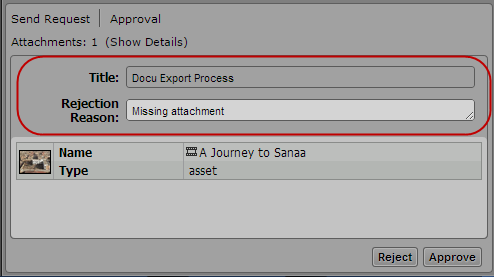

You can view and edit task metadata in the Task Details area. Which metadata fields are shown and can be edited depends on the configuration of the task template in Interplay MAM.
To display and edit the task metadata:
1. Select a task in the Task List.
The Task Details area shows the metadata fields that are configured for the task.
2. Click in a metadata field and type or edit the value; for example, type a reject reason as shown in the following illustration.
For information on the different metadata fields, see Viewing and Editing Interplay | MAM Metadata.
