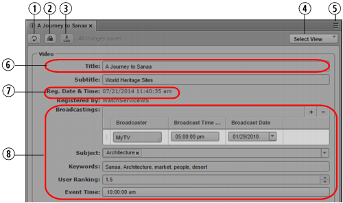

The Metadata pane displays properties that are associated with a selected asset in the Interplay MAM database, such as Comments or Creation date. Some properties are created automatically and others you can create or edit manually. In the Metadata pane, if a property is editable, a text box, drop-down menu, or other input control is displayed.
1
Refresh button
5
Pane Menu button
2
Lock button
6
Editable text box
3
Save button
7
Non-editable field
4
Metadata section selector
8
Examples for editable properties
