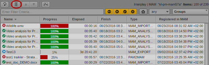

To enable and disable grouping:
*Click the Display Group Button so it turns orange.
Processes are grouped by the process group property in the Process List.
*Click the orange Display Group Button so it turns gray.
Processes are shown as flat list in the Process List.

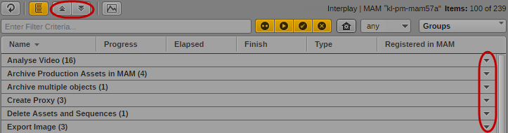

To show and hide grouped processes:
*Click the Expand All button to expand all process groups and show all processes in the Process List.
*Click the Collapse All button to collapse all process groups and hide all processes from the Process List.
*Click the Expand/Collapse toggle button or the header of an individual process group to show or hide its processes.

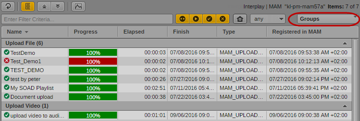

To apply a process group filter:
1. Click the Groups selector in the Quick Filter bar.
