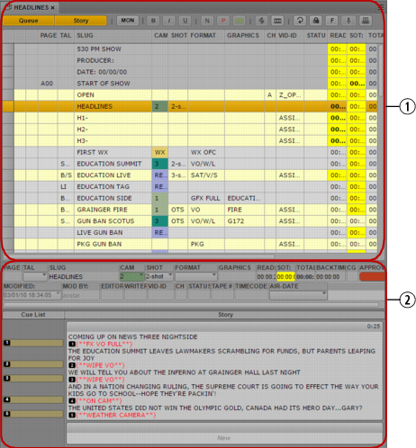

The Queue/Story pane can display either an iNEWS queue, such as a show's rundown, or a story in that queue. The Queue/Story pane can also display both a queue and a story in that queue, as shown in the following illustration:
1
The Queue section
2
The Story section, also called the Script Editor. For more information, see The Script Editor.

When only the queue is displayed in the pane, the display is called a grid view. When only the story is shown in the pane, the display is called a story view. When both are visible, the display is called a split view.
You can use the horizontal dividing line between the queue and story sections of the pane to adjust the ratio of the split view within the pane. When you position your mouse pointer over the dividing line, the mouse pointer changes to a double arrow. You can then click and drag the dividing line up or down to adjust the space allocated to each section of the pane. However, it is not recommended to use this technique to hide one section of the pane or the other.
