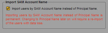

6. (Optional) If your facility uses SAM Account Names instead of the newer Active Directory Principal Names, select “Import users by SAM Account Name instead of Principal Name.” This configuration is specifically for those users who are used to logging into Interplay Production with the older Windows Domain style login.
If you later decide to change to Principal Name, you need to reimport users and the current settings will be lost.

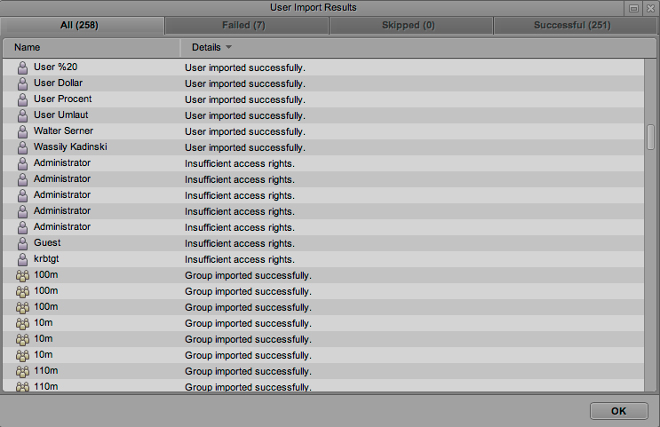

If the import process is successful, the User Import Results dialog box opens.
There are four tabs:
- All: Lists all users and groups and their status
- Failed: Lists the users and groups that could not be imported and their status
- Skipped: If you selected “Do not overwrite existing users that have the same names,” lists the users and groups that were not imported because they already exist in the user database.
- Successful: Lists the users and groups that were successfully imported.
The following table explains some messages that can prevent a successful import. Check with the Active Directory administrator to resolve these problems.
Message
Cause
Mandatory attribute ‘userPrincipalName’ not set.
The required userPrincipalName attribute of the user is empty. This can be caused by migrating pre-Windows 2000 users or by creating users without providing this attribute.
Insufficient access rights
The user account provided for the import does not have sufficient privileges to read the user information.
