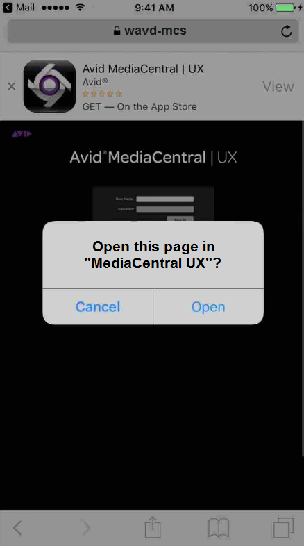

Version 2.10.1 of the MediaCentral UX mobile app for iOS enables users to more easily access these deep links. When tapping on a link in an e-mail from a forwarded message, the Safari browser opens on the mobile device and a tab for MediaCentral UX appears. MediaCentral detects the mobile device and displays a pop-up window; asking the user if they would like to open the link in the MediaCentral mobile app.
If the user selects Open, the MediaCentral UX app appears and requests that the user logs in. Once logged in, the user is directed to the linked asset. If the user selects Cancel, the pop-up window is closed and the MediaCentral UX tab in Safari remains.
If the MediaCentral UX mobile app is not installed, a banner at the top of the screen provides a quick link to download and install the app.
