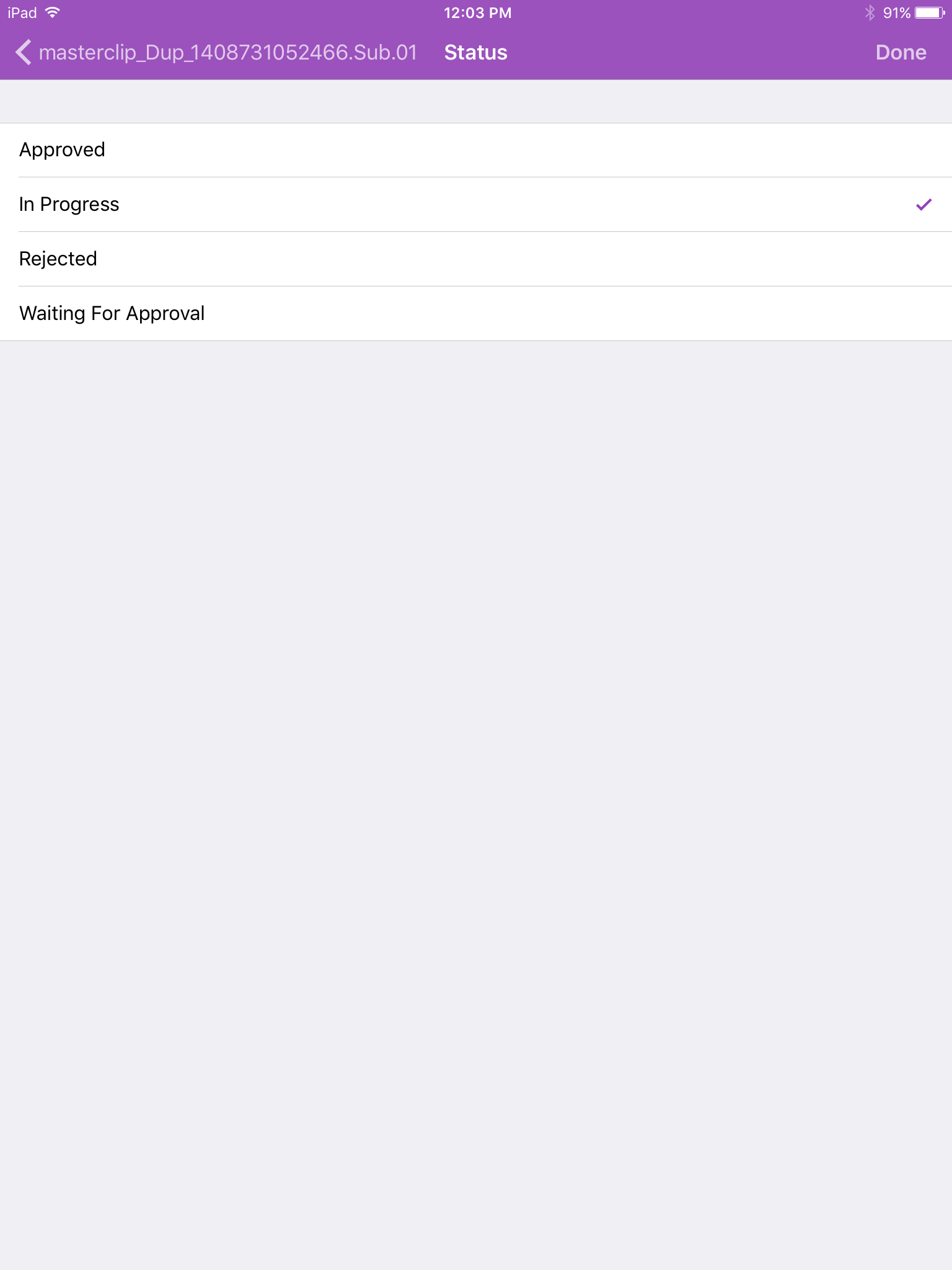

When enabled through the Interplay Administrator tool, a Status bar appears between the Media viewer and the Markers list. Tapping the Status bar displays the “Select approval status” window:
Assets are not associated with a default status.
The approval status window displays a list of options that can be customized as desired. When the user taps an item in the list, a check mark appears to the right of the selection. Tapping Done saves the selection.
To access the Status bar, your system administrator needs to create a custom property in Interplay Administrator named “Approval_Process” and import a manually created XML file that includes the status options. The options described in this example are: Approved, In Progress, Rejected, and Waiting for Approval.
*While the value names can be customized, the custom property in the Interplay Administrator must be called “Approval_Process”.
