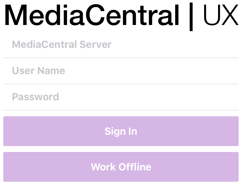

To start MediaCentral UX:
1. Select the MediaCentral icon to start the tablet app.
The sign-in screen appears.
2. Type the MediaCentral UX Server name.
3. Type your MediaCentral UX user name and password.
4. Do one of the following:
*Tap the Sign In button.
After you sign in, MediaCentral UX connects to the selected Interplay Production server or iNEWS system. All servers display in the Sidebar.
*If your MediaCentral UX credentials are incorrect or missing in your MediaCentral UX account, you receive a message: “Authentication Failed: The user name or password you entered is incorrect.” When you click OK, the sign-in screen appears and allows you to enter valid credentials.
*Tap the Work Offline button.
MediaCentral UX uses the credentials you used the last time you signed in, and it displays any cached queues and stories in the Favorites list.

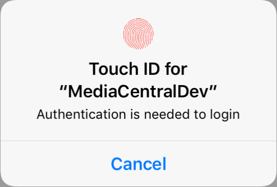

To start MediaCentral UX using Touch ID:
2. Press the Home button using the finger you registered with Touch ID.
*You must have Touch ID configured on your iOS device, and you must have manually logged in to your MediaCentral system at least one time using your system and user credentials.
*If your MediaCentral UX credentials are incorrect or missing in your MediaCentral UX account, you receive a message: “Authentication is needed to log in.” If you tap Cancel, the sign-in screen appears and allows you to attempt to log in using Touch ID or to enter valid credentials.
