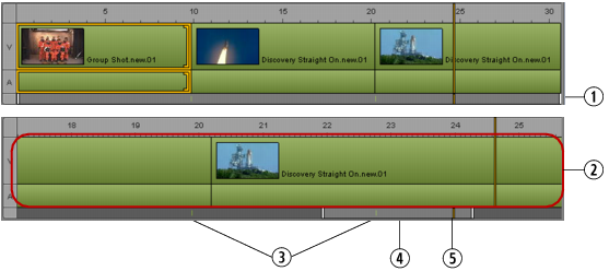

In the following illustration, the top timeline shows a basic sequence with the zoom bar set to show the entire sequence. The bottom timeline shows the sequence zoomed in to the middle portion of the sequence.
1 | Zoom bar | 4 | Zoom slider |
2 | Zoom region | 5 | Position indicator |
3 | Edit points | | |
The visible area of the timeline is referred to as the zoom region and is represented by the zoom slider. You can drag the zoom slider along the zoom bar to display a different zoom region anywhere in the sequence. The zoom region remains the same size as you drag the slider.
If a basic sequence is loaded in the Sequence pane, the zoom bar displays tick marks for edit points between segments.

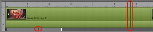

The zoom bar includes a position indicator that matches the position indicator in the Sequence Timeline and the Media Timeline. This position indicator is always visible in the zoom bar, which is useful when you are zoomed in to a section of the timeline that does not include the timeline position indicator.
Position indicator in zoom bar but not in zoom region.
You can click the position indicator in the zoom bar and jump to its counterpart in the timeline. The zoom region moves to and enlarges the section of the timeline that includes the position indicator.
Position indicator in the zoom bar and in the zoom region.
