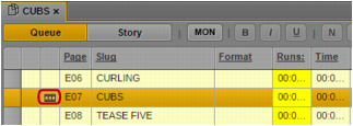

4. In MediaCentral UX, open a queue that contains the story whose sequence you want to open in Media Composer.
MediaCentral UX shows a sequence icon if a sequence is associated with a story.
