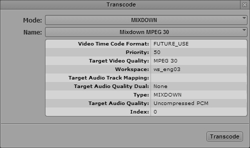

The Transcode dialog box opens.
2. Select a mode from the Mode menu.
3. Select a Transcode profile from the Name menu.
Transcode profiles are created by an Interplay Production administrator in the Production Services and Transfer Status tool. The Transcode dialog box displays the parameters of the profiles, but you cannot edit them in MediaCentral.
4. Click Transcode.
The Transcode process uses the selected Transcode profile and begins the operation. You can view the progress in the Progress pane, along with the target folder and the mode.
