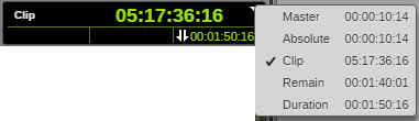

Clip: (MediaCentral UX v2.8 and later) In Output mode, displays timecode for the selected frame that corresponds to the original (source) timecode of the clip in the loaded sequence. This feature is especially useful when logging sequences. The following illustration shows the display for a sequence loaded in Output mode, with Clip selected.

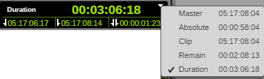

Duration: (MediaCentral UX v2.8 and later) Displays the total duration of a loaded asset in either Asset mode or Output mode.The following illustration shows the display for an asset loaded in Asset mode. Note that if you select Duration, the Mark In and Mark Out displays show the master timecode.
The following illustration shows the display for a sequence loaded in Output mode. Note that the smaller display also shows the duration of the sequence.
