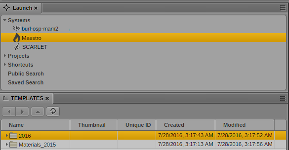

To open the Maestro template database, do one of the following:
*Double-click the highlighted Maestro icon and name.
*Right-click the highlighted Maestro icon and name and select “Open in New Assets Tab.”
The Maestro template database is displayed in the Assets pane. In the following illustration, the Maestro database has two top-level folders.
The Maestro database hierarchy uses a standard organization of folders and subfolders, as shown in the following illustration.
