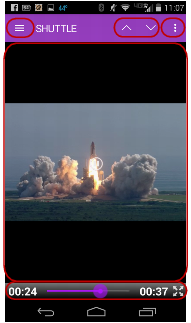

Media viewer — top: Up button, Previous/Next buttons; Action overflow button; middle: Media player; bottom: Media controls

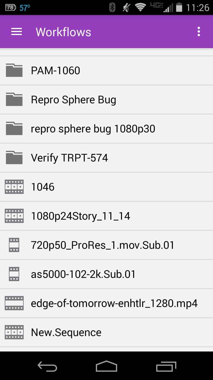

The following illustration shows the Workflows directory opened to view multiple subdirectories and media assets.

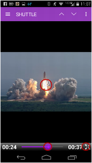

Media controls: Play button, position indicator, Full Screen button
3. Tap the Play button to play the asset.
4. If you want to scrub through the media asset, or if you want to jump to a specific position in the clip, tap and hold the position indicator and drag it to a new location.
5. If you want to view a video clip in full screen mode, tap the Full Screen button.
