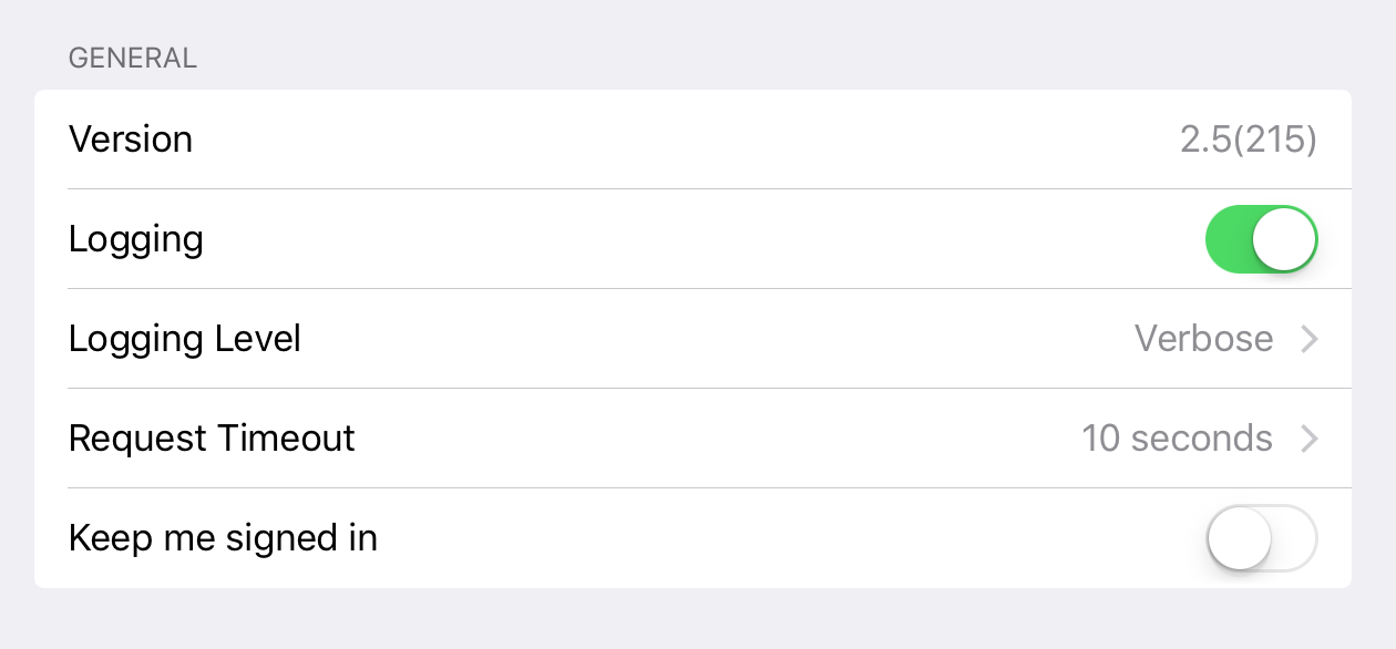

1. On your iOS device, tap the Settings icon.
2. Select MediaCentral UX in the list of apps.
The MediaCentral Settings screen opens.
3. Set Logging to On.
4. Select the Logging Level to Verbose.

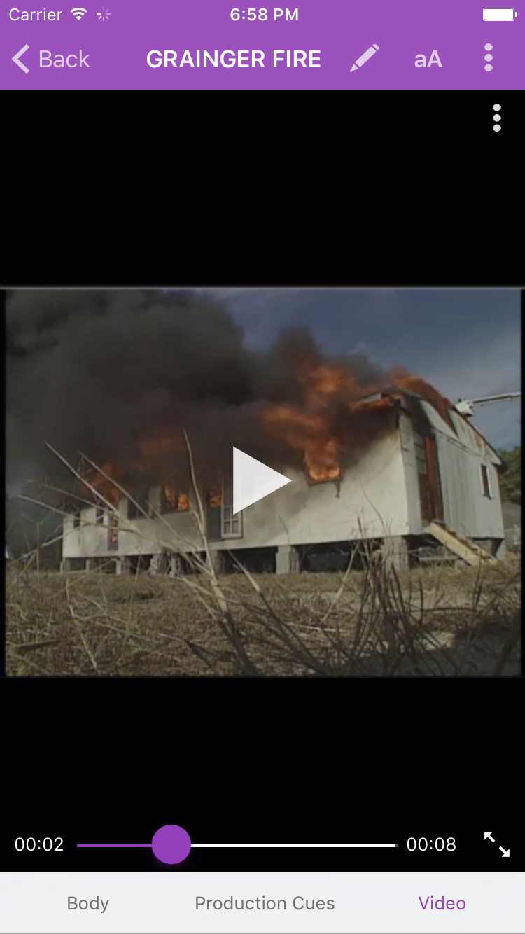

7. Tap the video asset.
The asset opens in the Media viewer.
8. Tap the Play button to play the asset, and make a note of the time playback begins.
