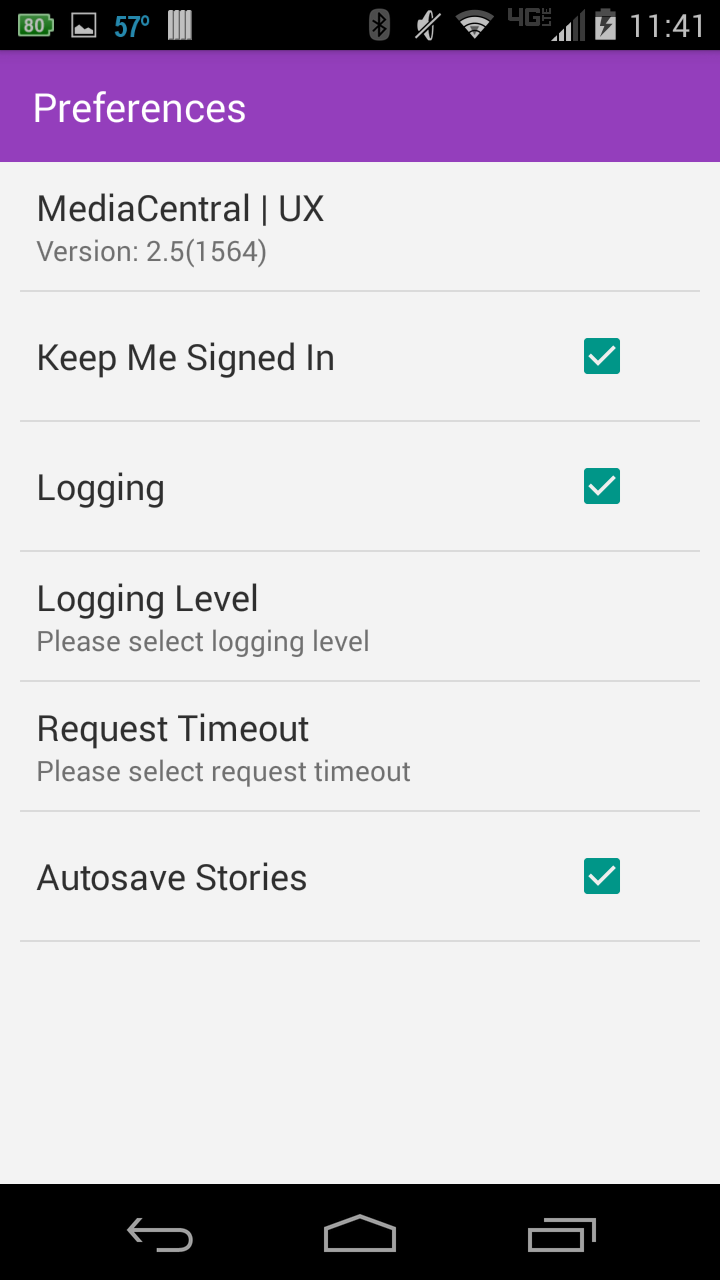

2. Tap the Action overflow button, and then select Settings.
The Preferences window opens.
3. Select Logging to enable logging.
4. Tap Logging Level and then select Verbose.
5. Click the Back button to return to MediaCentral UX.

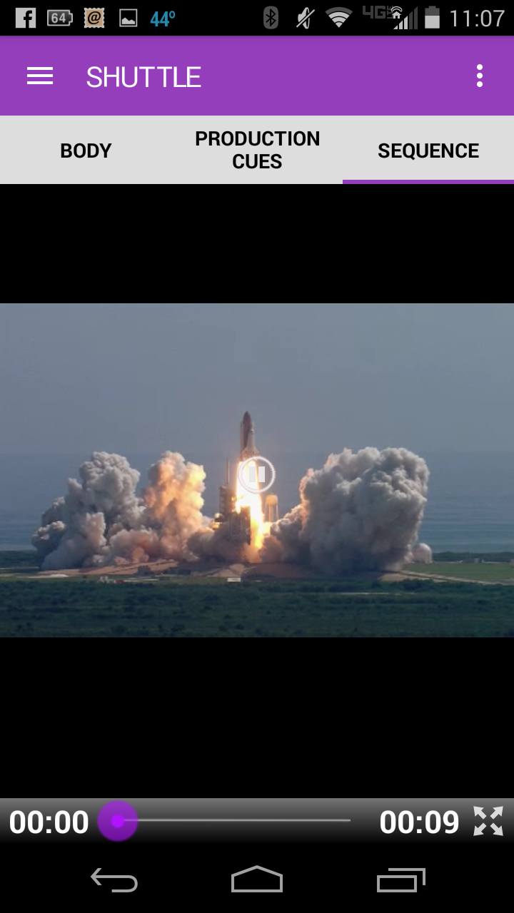

6. Navigate to an asset in one of the directories.
7. Tap the video asset.
The asset opens in the Media viewer.
8. Tap the Play button to play the asset, and make a note of the time playback begins.
