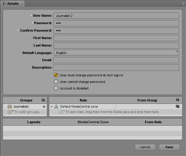

3. In the Details pane, type the properties for the new user.
User Name, Password, and Confirm Password are required fields and are marked by small white stars. Other fields and settings are optional.

4. Select the options you want, such as “User must change password at next sign-in.”
5. (Optional) Add the new user to a group.
If you selected a group and then selected Create User, the group you selected is listed in the Groups section. To add the user to another group, drag the group icon from the user tree to the Groups section.
If you do not assign a user to a group, the user is added to the top-level group (Users).
6. (Optional) Assign one or more roles to a user.
By default, a user inherits the role of the assigned group. This default role is not displayed until you save the new user. If you are working in a multi-zone environment, assign the appropriate role for each zone.
7. If you do not want to create the user, click Cancel.
This action clears the Details pane.
8. When you are satisfied with the information, click Save or press Ctrl+S.
The user is added to the groups that you specified.
